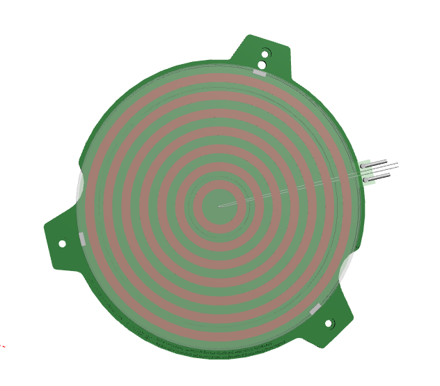

3) Heat Bed V3.0 - SOLVED!
We have a new heat foil with a thicker trace that can go as high as 110 degree Celsius. To further improve the system we have a laminate type of insulator (similar to Formica) that will be fitted under the heat foil to direct all the heat upwards towards the glass.
The materials from the bottom -> Laminate Insulator (in green) -> Kapton heat foil -> Glass, create a high performance heat bed (the V3.0 Heat Bed).
Heat Bed V3.0 Concept (Top View)

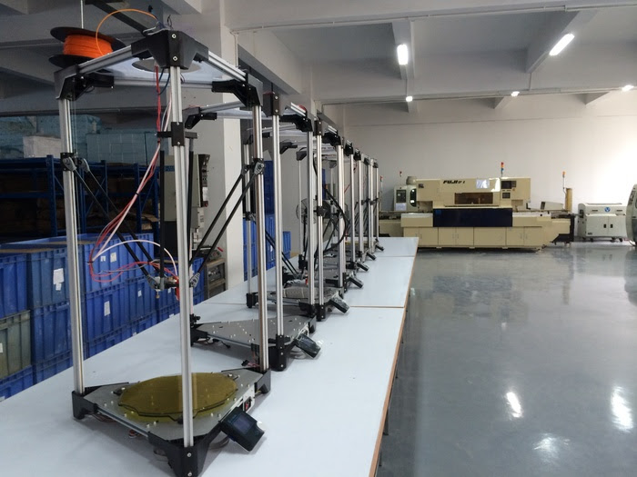

Shipping BETA units - Soon!
We currently have BETA units ready for shipment minus the hot ends which we are still struggling with. These units have been tested for motion and other components are functional. We plan to ship as soon as possible as our target was the 27th, but we could not ship due to the hot end issue we have at the moment.
Units in various stages of production (old picture)

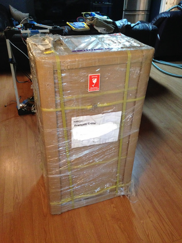

Shipping Test
Last week we shipped a unit halfway across the world to test our packaging system and we are quite happy to report that the unit was received with ZERO damage and 100% working condition. We also discovered that the unit is much heavier and bulkier than the V2.0. We might realistically need to increase the shipping cost from 60$ to closer to 100$ before we ship. We will confirm this in the next update.
First packaging test is a success!
