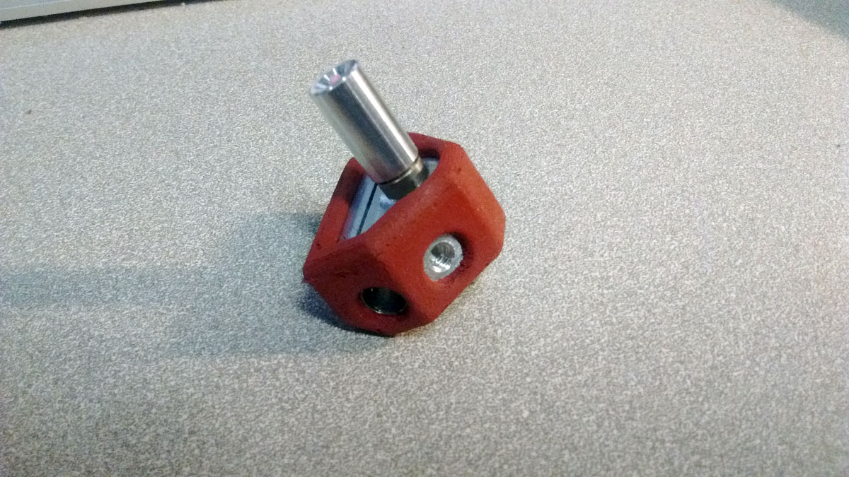

    My weekend project. It is for my hot ends with Microswiss parts. Decided to mold some silicon covers for them. This is the 4 up mold.
    https://goo.gl/photos/JXeEfmY7XMuDguPU8
    Very cool. Will these end up similar to the ones Flexion does on theirs?

    Quote Originally Posted by DaveB View Post
    Ya I suppose it might be similar.

    Not too bad for first try. Had 2 of the 4 fail, must not have got the 2 parts mixed good enough.
    That's really impressive. What goop do you use to make them?

    It is a Smooth-On brand product called Mold Max 60. It is their only high heat product. It is good for up to around 295c.
    ~pic snip~
    Very nice, I bet your nozzles will get to operating temp much faster.
    How much did ya pay for the goop?
