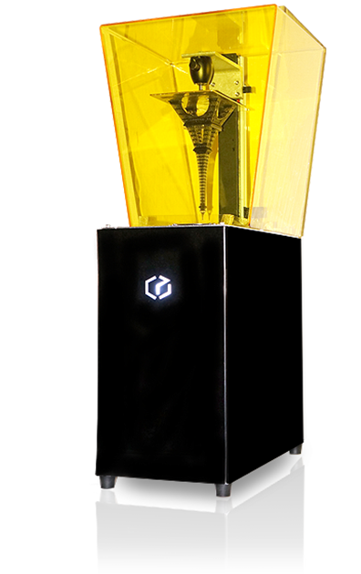

Kudo3D Titan1 3D Printer
Has anyone seen or heard about the Kudo3D Titan1 3D Printer? It almost seems like a device which is too good to be true. The specifications are amazing, however we do not yet know of the price it will come to market at. The Titan1 is an SLS printer which uses Resin, as well as a patent pending PSP (Passive Self-Peeling) technology. The printer will be compatible with pretty much all SLA photoresins sensitive to 400nm light.
Here are the Specifications of the Kudo3D Titan1:
- XY resolution: 37 micron to 100 micron
- Z resolution: 1 micron
- Build Size: 19.2cm x 10.8cm x 24.3cm (WxDxH approx)
- Print speed:
- 2.7 inches / hr for xy:50 micron and z:100 micron resolution
- 1.3 inches / hr for xy:100 micron and z:100 micron resolution
- 1.9 inches / hr for xy:100 micron and z:200 micron resolution
- Able to pause printing and replace resin with different color in the middle of a print
- Machine Size: 40cm x 30cm x 85cm
- Flexible PSP resin container
- High precision industrial grade linear stage module
- HD 1920×1080 DLP projector
- Mega 2560 and RAMPS 1.4 controlling circuit
- Nema 17 Stepping motor
- 12cm cooling fan
- Aluminum extrusion frame with steel enhancement
- Brushed aluminum case
The Company which was founded by Tedd Syao, claims that they have a min resolution of 1μm! That is incredible if it proves to be true. Most other SLS printers are 25μm and above resolution wise. The print speeds are also staggeringly fast at 1.3in to 2.7in/hr for Z 100μm, which blows away just about every ther sSLS 3D printer on the market. I have included a video below, as well as an image. What are your opinions? The printer can be found with more details at the Kudo3d Website.

Awesome specs, now we need a price. Judging from it's size I am going to guess we will see an price tag on the Titan1 somewhere north of $8,000, Probably closer to $20k. Just a wild guess on my part but this is a large machine judging from the picture above. I can't see it being priced anywhere close to a level where consumers would buy it.

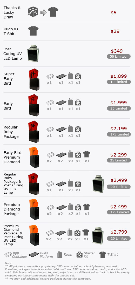

Looks like they have announced their Reward packages:

$1899 - $1999 for an SLA printer is pretty dang good. I hope these guys can do what they say they can do, because this will certainly make 3d printing a lot more attractive to the masses.
