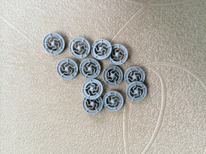

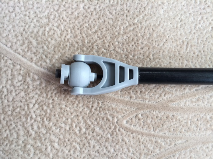

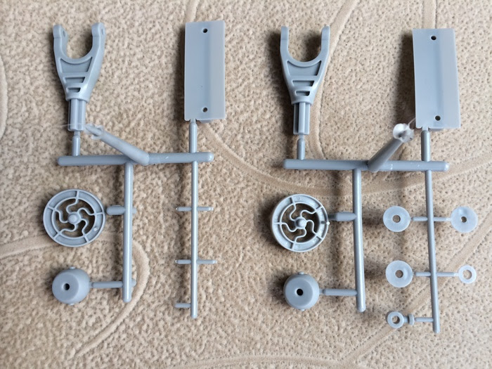

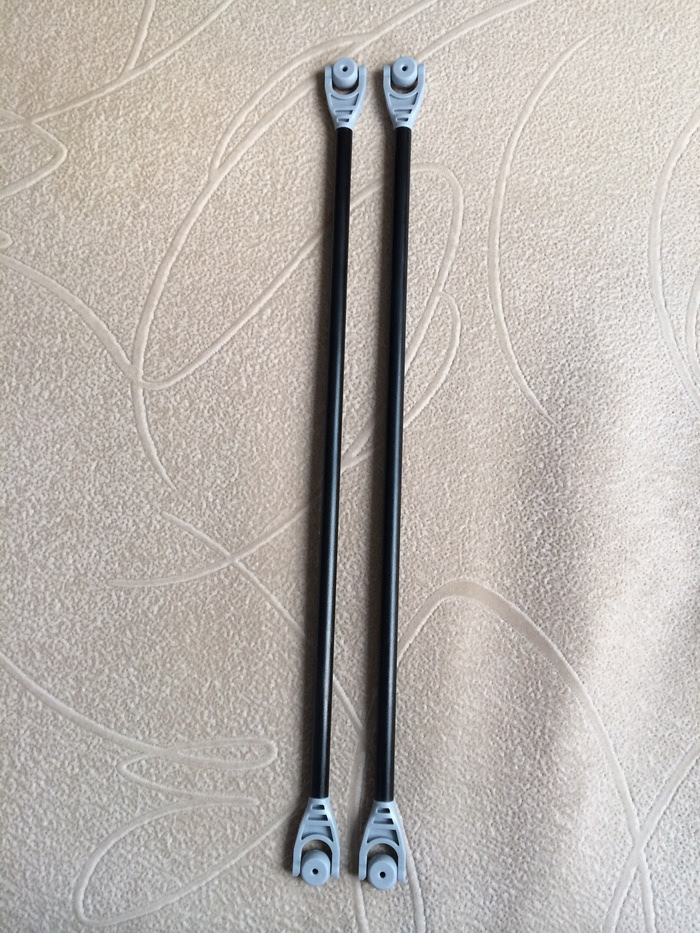

    In this update I will be showing some images of the injection molded and 3D printed parts and discussing some delays to the Kickstarter schedule.
    Currently, we are in the process of adjusting the molds to achieve perfect tolerance on all the parts. Because we use POM material to create joints, we need a very good fit between individually molded parts. This process is time consuming as each modification requires additional machining of the molds and a re-run of the samples. What happens when you initially cut a mold is that you have to factor in the plastic shrinkage, warping and the fact that corrections can only be made by removing material from the mold (you can never shrink the parts, only make them bigger). As a result, the safest approach is to make the mold a little bit smaller and work your way out.
    I will be providing some details below, but this means that we will now only be testing the first units at the beginning of May. After we have completed our initial testing on 10-15 units, to make sure we are 100% satisfied with the BI V2.5, we will be entering main production where we expect to have all units shipped within a 2-4 weeks timeframe.
    Injection molded parts:
    Mould 3 - POM Material - Arm tips, T slot Slides, Extruder Tension Wheel, etc.
    Delta arm with arm tips and joints
    Arm set with tips
    New self tensionning extruder wheel - To replace simple bearing
