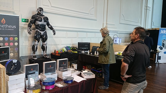

Two months we are working on the project 3D printing life-sized suit of Crysis 3.
Print lasted three weeks, the rest of the time devoted to combining pieces, smoothing, painting, wrapping foil and fine-tuning the details.
The project was shown on October 18/19 3DPeurope in Brussels.
Thank you also for giving consent to the official demonstration, a producer of game company Crytek.
Printing was made at 11 parts per printer ProCoPrint3D / ME sized working area 40/45/55 cm. The printer is equipped with two heads and 8 stepper motors and a 32-bit motherboard.
An important fact is that the print was made without the use of a heated table to hold the model we used glue PROGLU3D PLA-Cold.
