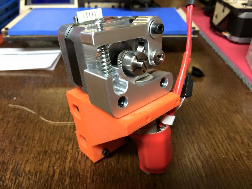

    Extruder wise, I've decided to use a Printrbot aluminum extruder, and a Ubis hot end, as these were left overs in the workshop, however the extruder mount has been designed to also accept Hexagon and E3D hot ends as well.

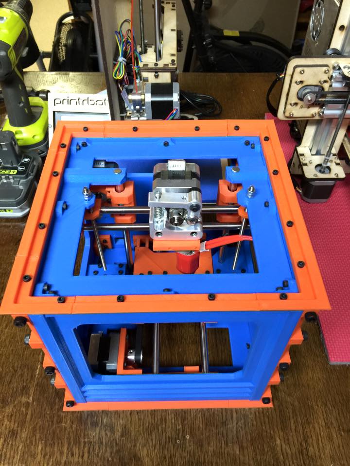

    Well after a short delay waiting on the mechanical components to arrive, and revising a few parts here and there, we're finally onto the build!
    The frame went together well with very few issues, although it was a more prolonged build thanks to the multitude of screws and tight spots. Overall though, the frame went together well, and is superbly strong. The inside corner brackets, combined with the outer corners, and top and bottom frames, make the entire frame rock solid, and as heavy as a rock too. Given that the bulk of the printer is plastic and screws, it's amazing how much the entire unit weighs!.
    The linear rods, bearings and other little bits have arrived, so tonight will hopefully see most of the printer completed!
    The top side of the frame
    The bottom side showing the lower frame/feet for the printer and the bottom inner frame
    The inside of the frame, inner corner brackets, and Y motors in place

    It's that time again! There's been some good progress made this week. The extruder and bearing holders were put together without issue, and yesterday marked the installation of the linear rods into their respective homes. So far, the build has progressed well with little modifications needed, however I will be redesigning the extruder carrier slightly to make the GT2 belt installation easier.
    Cheers
    Ryan

    The extruder choice was purely down to what I had laying around the workspace, and was also the smallest of the extruders I'm familiar with. I may try for a printed direct drive extruder in the future though.

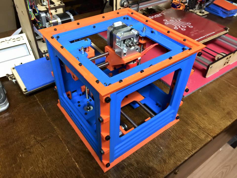

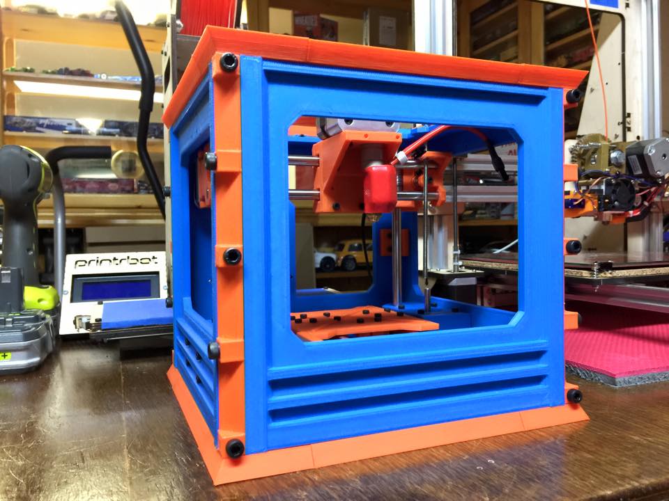

    Well after a week or so of tweaking and other projects on the go, I present to you, the finished printer.
    I'm fairly pleased with the final outcome and functionality of the printer itself. There was initially some concern over heat and softening plastic being an issue, but after several calibration prints, it hasn't been an issue. The overall build volume is just under 4" cubed. I will be releasing the original drawings and STL's for the printer in the next while for anyone who wishes to print their own or have a look at its design. I've already started planning on the next generation of this printer, and to hopefully offer it to the public in the next while
    Cheers
    Ryan
