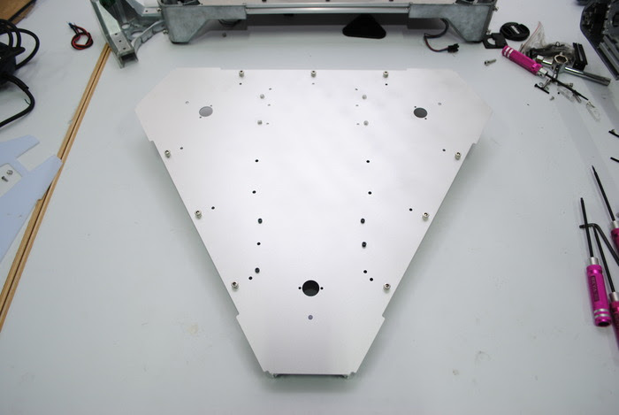

3) Heat foils had to be redone to support a true 100 degree Celsius performance. The previous trace was not adequate and took a very long time to reach operating temperature. We will soon publish the new design along with the print surface fixture.
https://ci5.googleusercontent.com/pr...JPG?1402455901Latest revision of the print surface support pane laser cut in aluminium

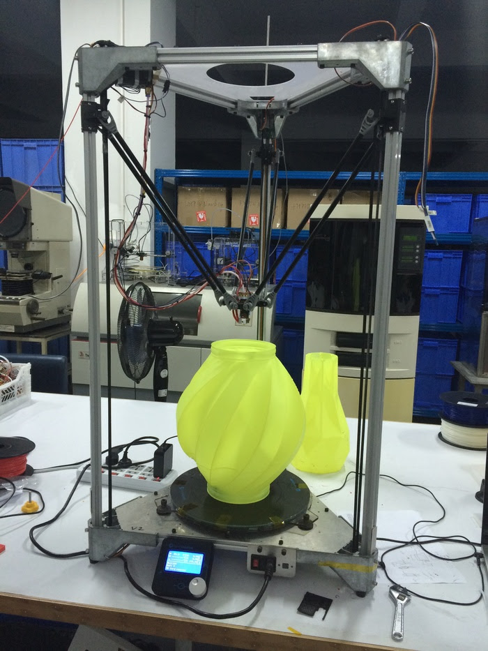

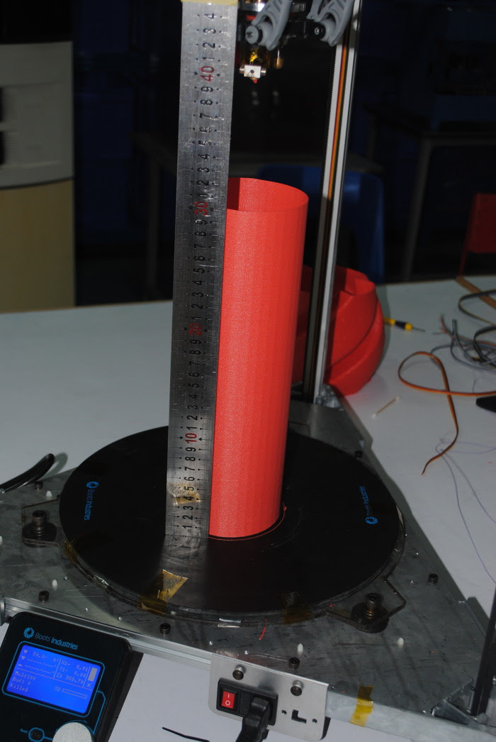

We've been testing extensively to get the best settings for the machine.
https://ci3.googleusercontent.com/pr...JPG?1402454750Test Print to check dimensional accuracy
https://ci4.googleusercontent.com/pr...JPG?1402454568One of our test printer - Printing vases for fun and to evaluate the print quality!

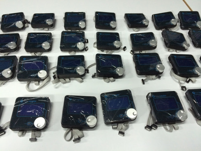

LCD modules are all ready to go:
https://ci5.googleusercontent.com/pr...JPG?1402454120Some LCD modules among the 400 we've prepared

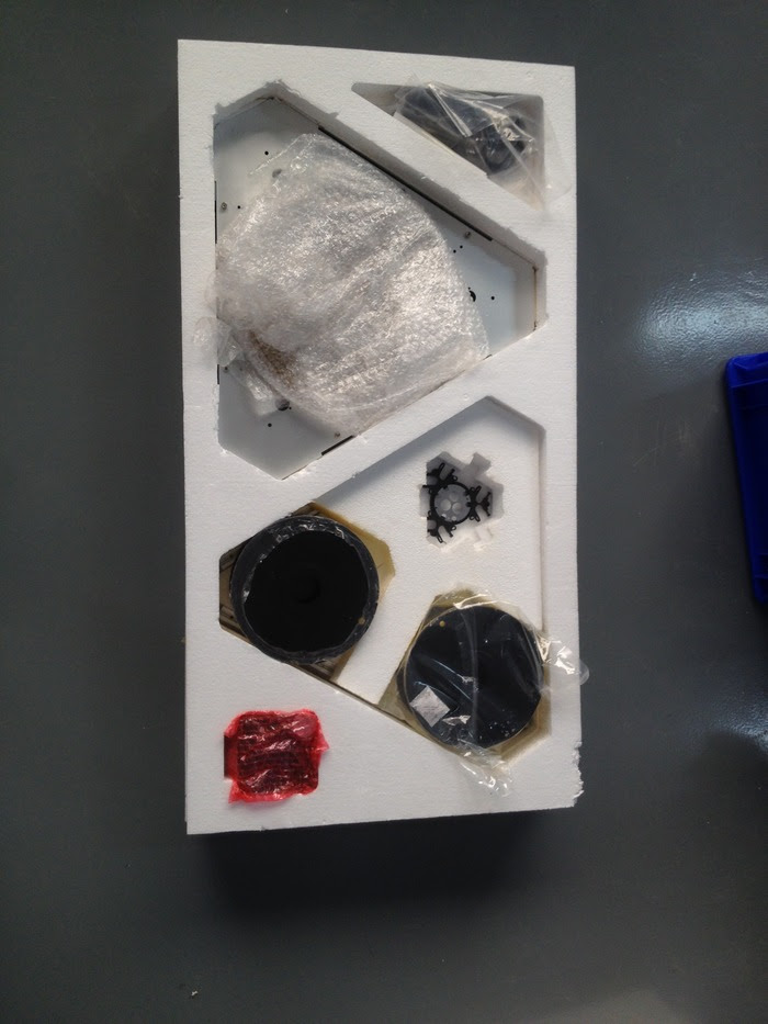

Packaging concept is ready and undergoing a ship test this week
We've created a high quality shipping concept and will test it this week by shipping a back and forth to see if it survives 100%. Below are some pictures to illustrate the concept.
https://ci5.googleusercontent.com/pr...peg?1402456350One of the two inserts that will be found in the box you will receive
https://ci3.googleusercontent.com/pr...peg?1402456449The three motion axis (most important part) protected by our packaging concept

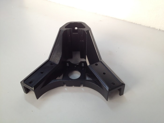

The final printer will be black
A sample corner just came back from the paint shop. This gives a good idea of the final look: the machine will have.a beautiful black matte look. Limited edition blue printer will also be produced for higher tier backers.
https://ci6.googleusercontent.com/pr...peg?1402456607Black Matte Color
